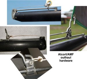

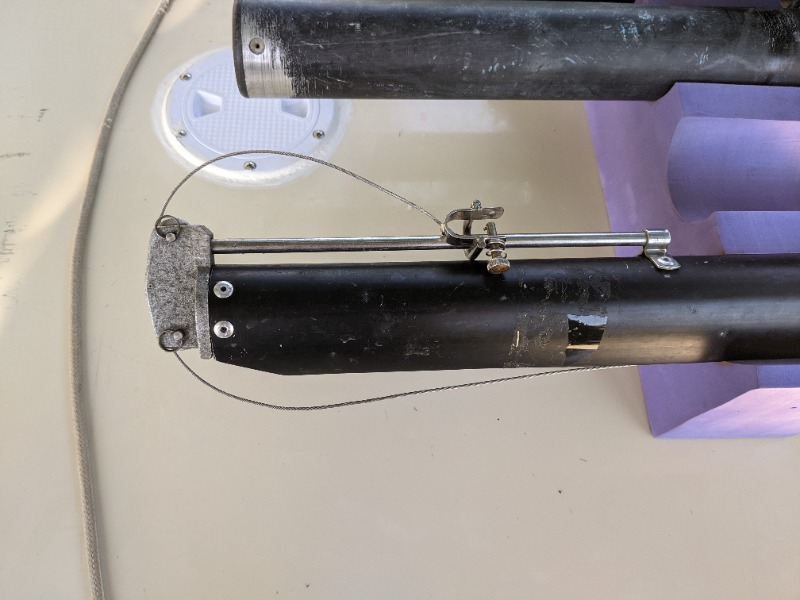

Hello and WELCOME Nick, can you attach a photo of the end of your boom?
Normally there is a hook that goes into the clew grommet on the sail, slides along a rail and is attached to the outhaul line which then goes around two sheave and under and into the boom back to the mast where there is another sheave that turns the outhaul line back to the deck. Anyone got a photo for Nick?
Edit: found two

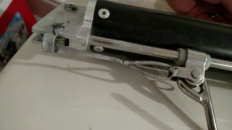

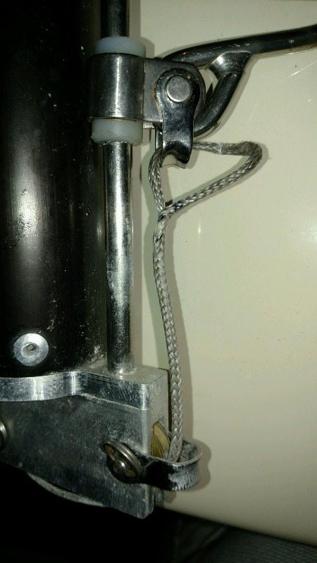

Thanks for the speedy response. I can attach pictures later this week. What does the hook look like at the end of that assembly? Either I am over estimating the need or defined quick release for the clew or missing the quick release part of the pictured assembly.
