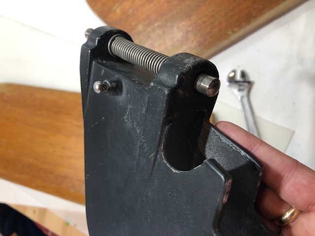

16 Jan 2021 14:08 #27 by Acornrunner
Replied by Acornrunner on topic COVID 19 Boat Projects
Replace or hope for the best?  I have a feeling this is a common ailment, seems like I read about a "new" caastings?  Whats the worse that can happen?Replace or hope for the best?  I have a feeling this is a common ailment, seems like I read about a "new" caastings?  Whats the worse that can happen?

19 Jan 2021 09:34 - 20 Jan 2021 10:50 #28 by Chris Z
Replied by Chris Z on topic COVID 19 Boat Projects
That pin can just be tapped out with a hammer. I would suggest fiberglassing the head after you sand down to bare wood then poly over it.
On the rudder head, I would see if someone can weld the aluminum and I would have them scab in a piece where it broke unless you have it. I don't feel that is a high stress area.

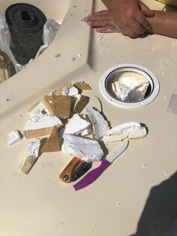

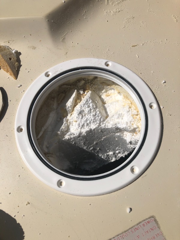

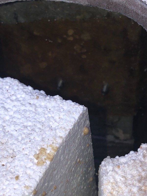

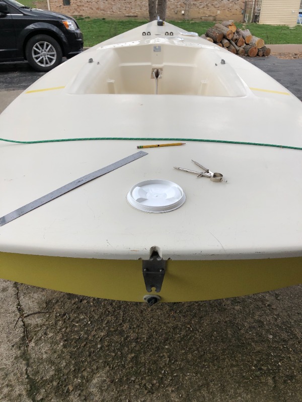

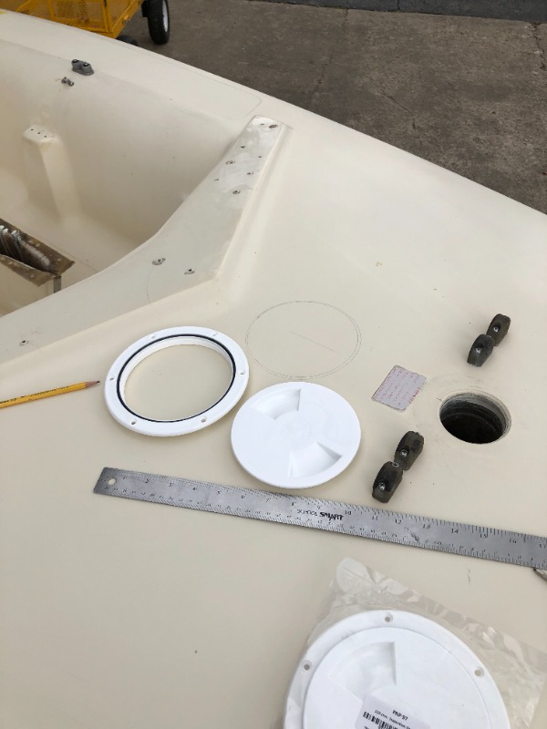

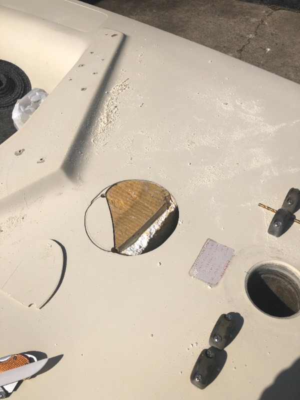

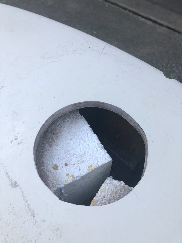

27 Apr 2021 10:31 #29 by Acornrunner
New inspection ports installed, rudder attachment plate strengthened with fender washers and nuts, so it will rip out the whole transom if she goes.
